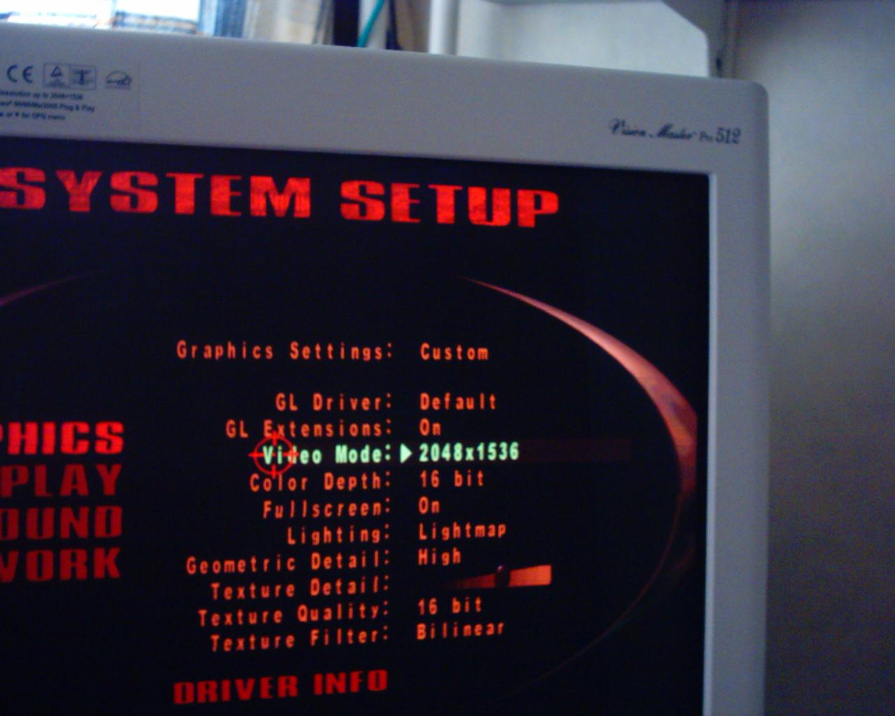

Now it works thanks to our friend obi one ;)It had to take away the mesafx file because of the 1600x1200 limit. And the colordepth must be set on 16bbp. The result you get is awesome! Next thing is to find a glide game with such a resolution [:p]Well ill put an image here as prove but an ingame image looks bad. The cam cannot take pictures of such fast moving frames unfortunately. Maybe some time ill make a screenhot if you want. Wel im off tomplay some more games @ 2048x1536 :)....and don't forget we owe it all to OBI WAN
437.48 KB
p.s.)before i forget Q3 : 2048x1536x16 = 52.8 fps
