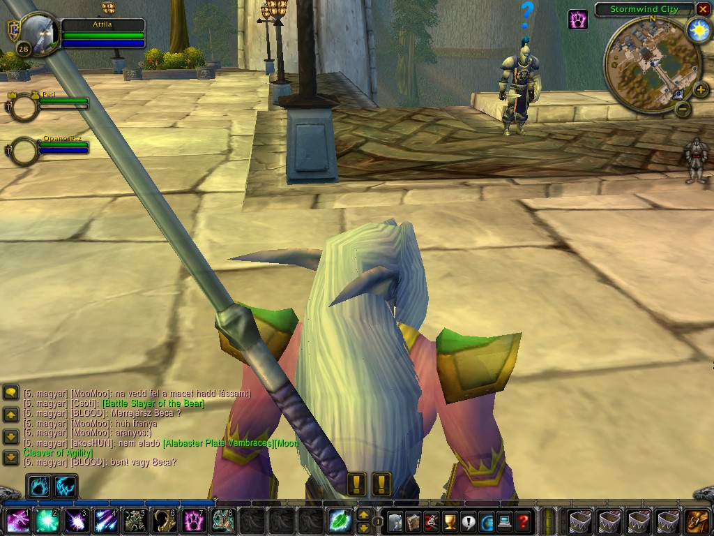

Hi. My card is running on 166mhz, and its generating bugs[:(] The card is very hot, maybe 60-70c°... I cleaned the cooler, but its didnt solve my problem. When Im downlclock the card to 160mhz, its work fine... But I dont want to downclock [xx(]
System: AMD 2700+
       ASUS A7N8X-E Deluce (nForce 2 Ultra)
Windows Reinstalled. +SFFT 33
Download Attachment: WoWScrnShot_012002_140339.jpg
223.97 KB
Note: See the Night-Elfs hair. Whit NFS Most Wanted, I got the same problem...

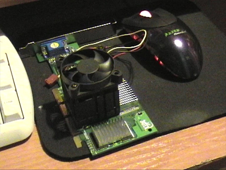

I Modded my card. Now its only bugging a little... whit this big cooler... I cant belive..
97.68 KB
Mikulaish
Well anything you do, try to take care of that card. That is rare.
