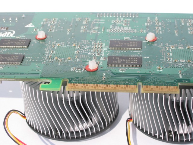

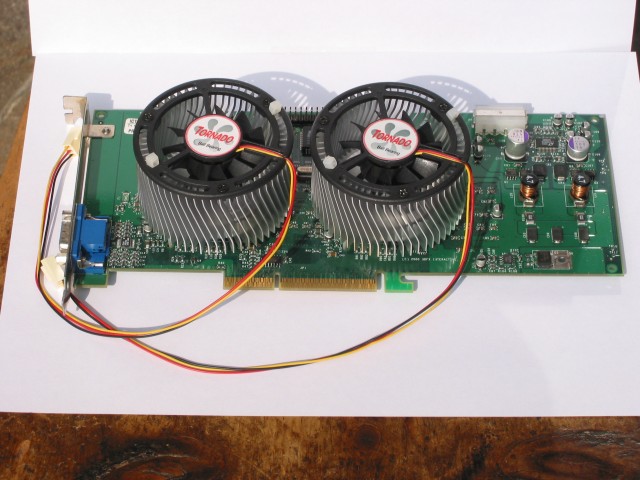

Hi guys, I run my V5500 AGP with two Termaltake Tornado Orb Socket A coolers since August 2005. Have a look here:
78.37 KB
93.84 KB
With those two coolers it is possible to cool the VSA100s completely passive. I didn't remove the fans though because I needed the black plastic case of the fans for the cable ties that hold the coolers on the GPUs. I was very sceptical at the beginning if this would work out, especially because the coolers are pretty heavy and the card is of course mounted with the coolers hanging downwards, but everything worked out fine.
I bought those coolers on eBay, a pack of 5 for 8€ or so, so it was the cheapest solution for me. I came to this rather monstrous solution, because I wanted to build an oldschool gaming PC that was very silent, and because a friend of mine tried to cool his V5500 with two passive coolermaster northbridge coolers, I don't remember the exact name, but they were passive Heatsinks like the Zalman NB32 and this dind't work out very well. He had to mount an additional 80mm fan which blows onto the headsink, otherwise the card would overheat pretty fast in 3D mode.

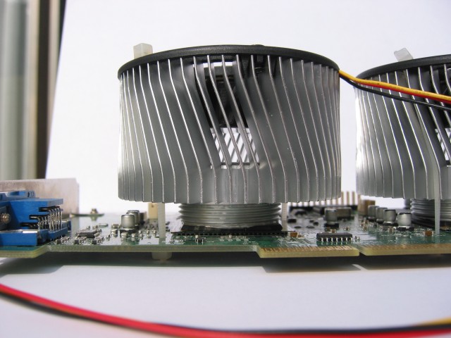

.SLeEP
As you can see in this picture the Tornado Orbs have some sort of mounting thread at the bottom where the original Socket A mounting plate was screwed on. That's why they absolutely don't interfere with any components on the card, because they reach their full diameter at ~8mm above GPU level...

.SLeEP
well, actually I use it on a MSI 6167 SlotA Mobo together with one SbLive 4.1 PCI Soundcard, a D-Link Gigabit PCI NIC, and one "oldschool" Realtek 10Mbit ISA NIC with BNC connector - hrhrhr:D.
But you're right, that Cooling Solution blocks 3 PCI slots...
trigger
.SLeEP  ......that's fricken awesome dude! Nice one! :D
I guess you could hook those fan lines up to a switch if ever you wanted extra cooling power! Or would that ever be needed?
Did you use any thermal paste and those are cable ties right?

.SLeEP
#25
Yes, those are cable ties. I used some old Arctic Silver 3 Thermal Paste I had lying around.
I did this mod back in August 2005, and so far, didn't have any problems with it.
By the way, the PC is running pretty much 24/7, I use it as some kind of server...and of course occasionally for some oldschool gaming.
The two fans are currently not connected. The Voodoo is running completely passive. I also tried them at 5V (they are of course 12V fans). You don't really hear them at 5V, so this would be a good option if you want to use this mod in a case thats badly ventilated. But since passive is enough for me, I didn't connect them at all...
