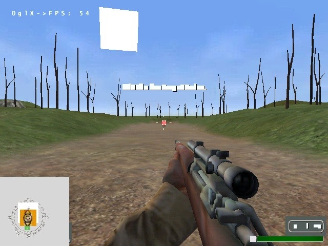

Doom
OglX version 0.1 :D :D
31.91 KB
V5 5500 with 1xVSA100
I think those damn DXTC textures cause this dreadful image. I think the only way is to convert those textures. Maybe it can be done manually, every texture can be accessed. But I am not sure if the map will give errors like can't find texture.

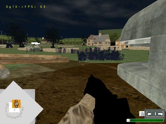

Doom
yes ,this is possible to do
with map isnt problem ( Q3 have in maps textures without extension and in loading function testing what texture type exist on HDD)
57.75 KB
Is the last image a example of how it looks with normal textures???
Or are these still the normal DXtc ones, look at the arm that seems to look normal? And I thought that some of the textures in CoD are not Dxtc, which is probably why tha arm looks correct.

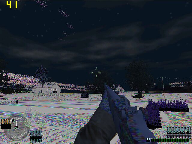

Doom
48.02 KB
@Doom nice work,
About those .jpg textures. Didn't the .tga textures work as well as the .jpg ones? You where right with the lighting being incorrect, maybe something can be done by software emulation? I don;t know what exactly has been changed in the Quake3 engine in the lighting department, but I do now that exactly the lighting in the CoD engine is changed I will search if it is something that the V2 can't support.

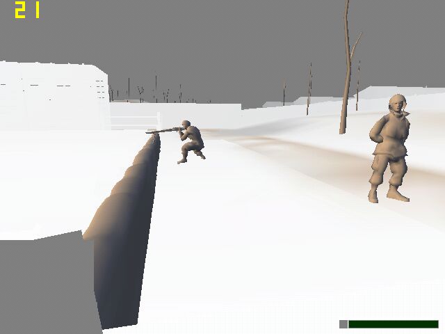

Doom
#6
yes .tga textures works ok, but i dont have HDD space fot .tga
lighting problem is now fixed:
83.68 KB
The pictures are surprizing !
(what's the problem with the hdd ?)
Doom
