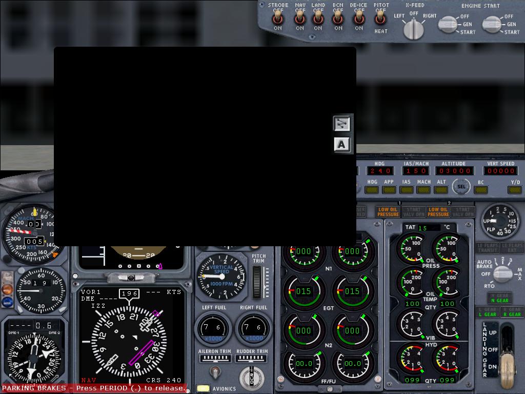

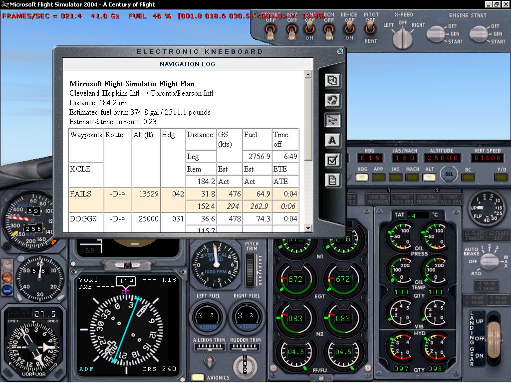

The only problem I see that need s to be fixed is the way the kneeboard display with the flight simulator (see the two pictures) on shows the kneeboard how it pops up when opening it while in window mode. The second is how the kneeboard opens while in full screen. First I get a black square then as I drag the mouse across it the display and control buttons start to appear. I wonder if this is affected by refresh. The first thing that happens after clicking the button to open the kneeboard is that the screen goes completely black momentarily the black square of the kneeboard is displayed. This occurrence is only in full screen mode. It may even be a setting in my display but it seems I have tried everything. The SFFT version 2 or 3 it seems to work fine. Other things to note is that the setting is with 2 sample AA. Now with no AA (fastest performance when I open the kneeboard I get the same black screen and poor display of the kneeboard  along with real poor frame rates the FPS drops 1FPS and as I change views I get a slide show.

FBS have you tried the same tests in single chip mode.
FBS
#71
This evening I tried both of the games with the AA settings set to single chip. In the Flight simulator game, the problem of the kneeboard showing up black in full screen mode was gone. There is a slight monitor flicker but overall it displays well. I tried ghost recon and it work as well as it did in 2 sample AA.
