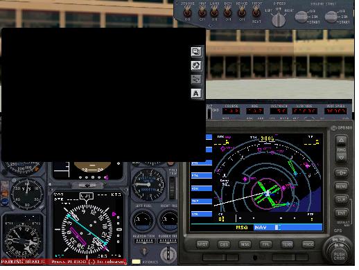

I got to test the SFFT9 drivers this morning for about an hour before having to go to work. I have not completly checked everything but what I have so far is that using the Flight sim software I still had the kneeboard problem with AA set to Fast and 2 sample, in single chip mode the kneeboard worked fine (note: this problem is in full screen only in window mode the kneeboard works fine in all AA modes). I have not seen any desktop corruption yet. Later this eveniing I will try the drivers some more.

Testing the SFFT9 drivers I have no problems with them, they function very well. SFFT if I can give you more input to fix the flight sim kneeboard please advise. What I can say is I think if you open a 2D window in a 3D image may be the cause. You see there are other windows such as the GPS seen in the picture below that open without any problem.

To add some more info on my kneeboard, Performance is worst(FPS)with AA set to Fast compared to 2 sample, when kneeboard is opened.

Today I loaded another software that runs with the Flight sim. This software controls the forces of my forcefeedback joystick. It runs in the backround with no visible windows. But is interesting that happened is that in AA 2 sample the kneeboard works fine now, when I run the sim with Fast AA the sim Frames run at 1FPS this makes the sim not even runable. Its like watching a slide show( did not even attemt to open the kneeboard I just returened it to 2 sample AA.

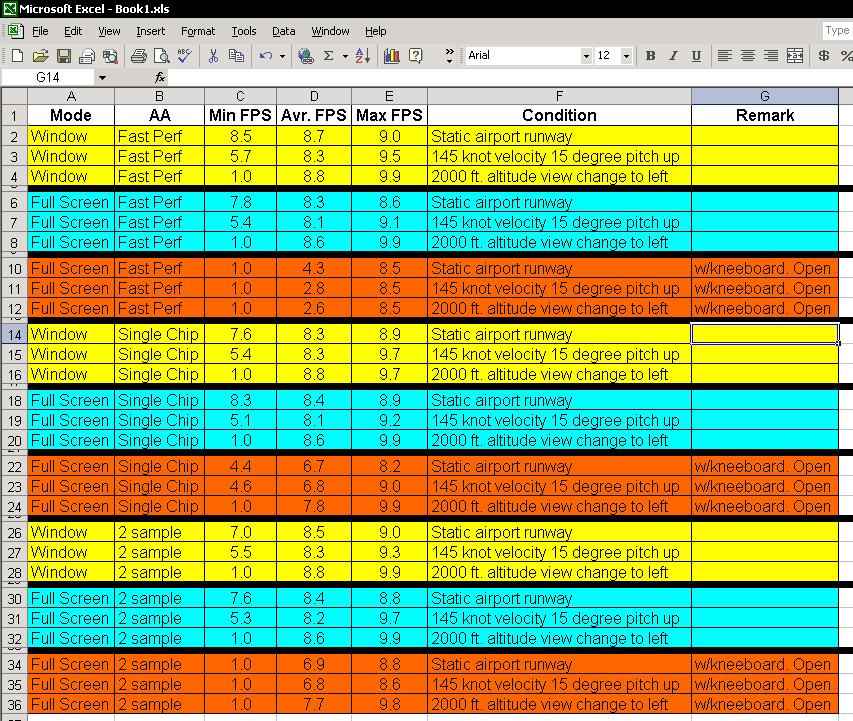

FBS Could you test the performance using Single Chip Fastest and 2 sample modes. I would suggest that you reboot the machine after changing the modes before doing the testing to ensure that the requested mode is set.
FBS
Here is some data collected. I created a video in the Flight sim and replayed it with the different card settings. I do not have any benchmark software so this video would assure stability in conditions being played.
225.16 KB
