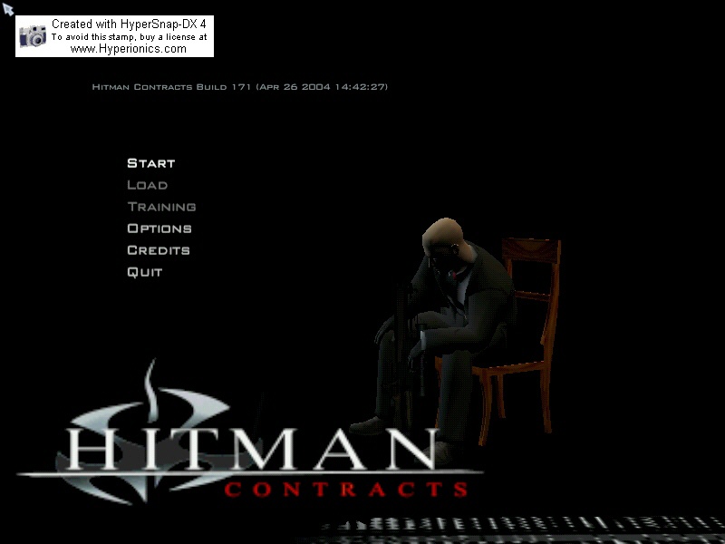

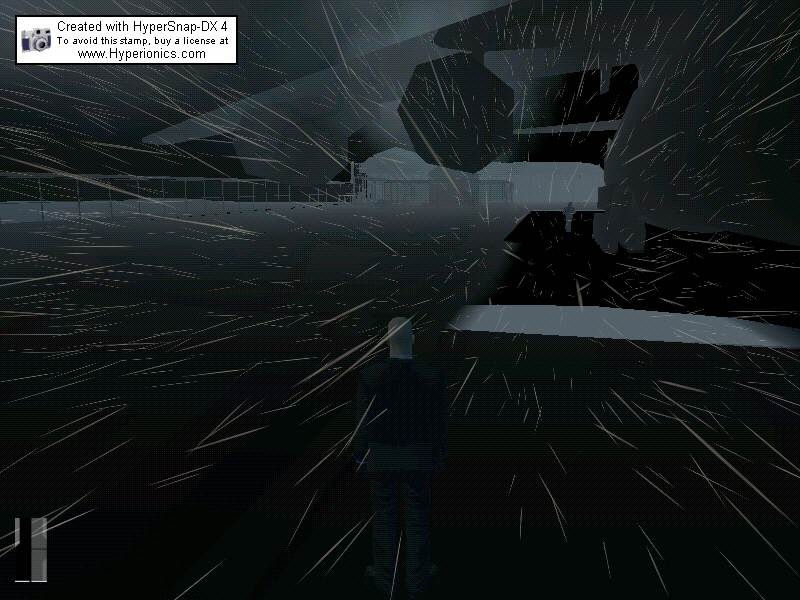

ok,so heres the stuff.
hitman contracts,voodoo3,mesafx6.1.0.5 and newer,texus2 on or off (its the same[B)]).I always use bat files when I need to mess with envvars..
67.25 KB
75.06 KB
hitman contracts runs perfectly fine with mesafx6.1.0.4 and texus2 disabled.(pics here)

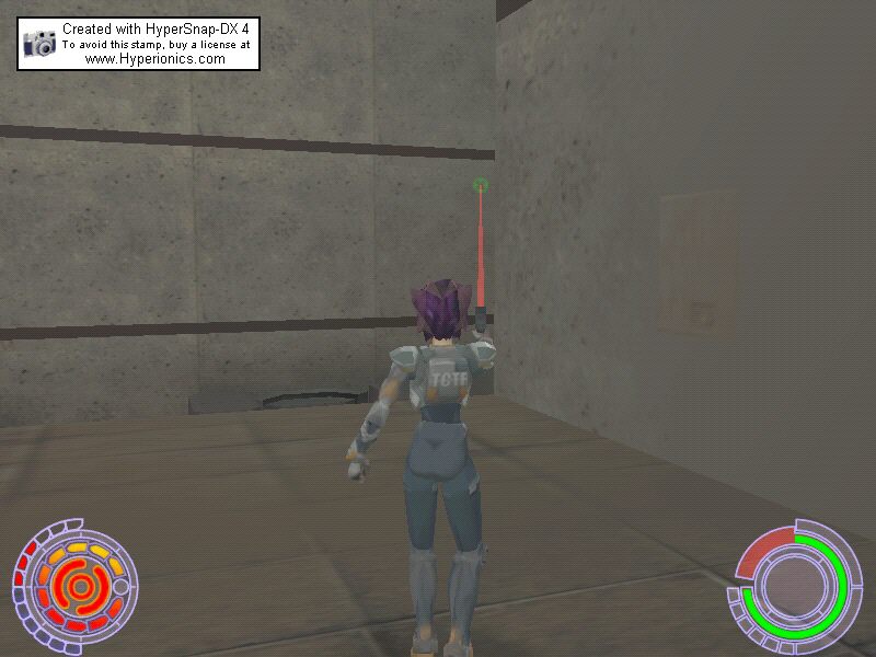

oni,voodoo3,mesafx6.1.0.8
78.17 KB
oni is greyish on voodoo5 as well,(intro and the game itself),but its not as bad as with voodoo3.I was not able to make a screenshot on my voodoo5,but the v3 pic should be enough.there is also another problem,all ground textures that are a bit more far away (next level of LOD) are grey (or have a weird colour).this looks like a glide problem however,the glide3x from koolsmoky fixes this (the one from the bloodrayne patch folder;))

Oh I remembered: indeed, ONI looks worse on my V2-based card, than my Napalm-based card. Maybe V3 has the same issues...
No problem for me with ONI and MesaFx 6.1.0.8. and voodoo5 5500. All looks ok and no problem with the menù.
