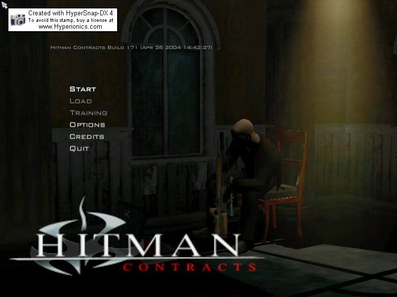

ok.I think the hitman contracts problem looks like this:
6.1.0.4->I can disable texus2->everything is fine.
6.1.0.5 or newer->I cant disable texus2->graphic issues.
looks like turning texus2 off with bat file DOES NOTHING..
Dude, what issues? I don't even know how it's supposed to look like.
hmm,my english is probably worse that I thought[xx(]
I will try to put it as simple as I can.
I'm running hitman contracts demo on my voodoo3 3500tv.
I use opengl and mesafx.
mesafx6.1.0.4 works fine,you must ENABLE SW rescaling to fix white textures,and DISABLE TEXUS2.if you do this,the game runs and looks the way it should.
if you leave texus2 on,all textures are just a black mess.
with mesafx6.1.0.5 or newer I have disabled texus2,but the textures remained black (posted pictures,page 25 of this topic)
it looks like I cant disable texus2 with 6.1.0.5 or newer..

#506
you are right,the main menu looks that way only during that flashing effect (lightning strikes outside;)).the main menu should look like this most of the time:
73.59 KB
as you can see,there is no graphic corruption,the room is a bit darker but still good visible..(just for the record,vodooo3 3500tv,with mesafx6.1.0.4.,sw rescalling on,texus2 off;))
#507
as you can see,there is no graphic corruption,the room is a bit darker but still good visible..(just for the record,with mesafx6.1.0.4.,sw rescalling on,texus2 off;))
