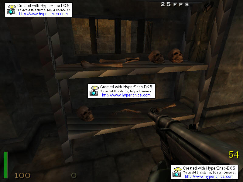

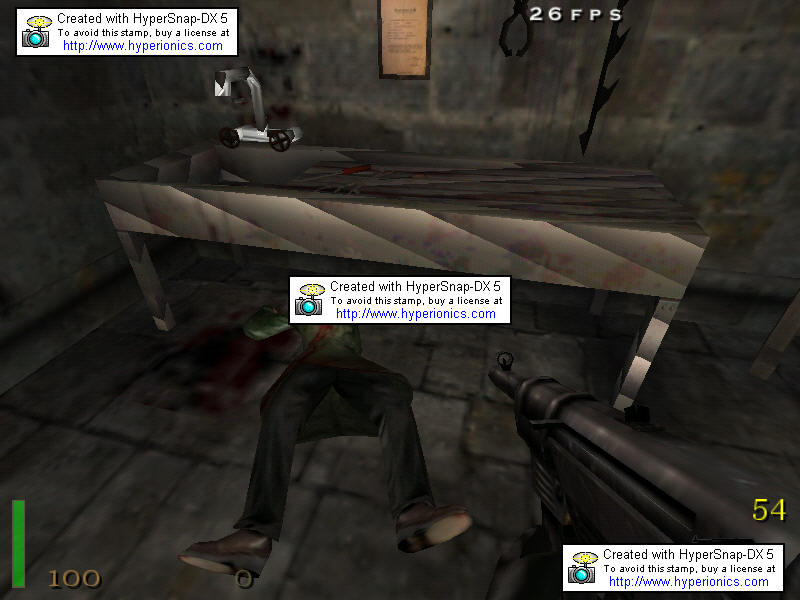

I have tried mesafx with my voodoo2,the tested game was return to castle wolfenstein.the game runs and looks great with medium/normal settings and 800*600 resolution(25-35 FPS,sometimes drops to 15-20).however,I have encountered a bug,with lightning set to light map (high),the shiny surfaces (like steel or gold objects) are not displayed correctly (see the pic).no such problems with my voodoo3.
68.6 KB
66.01 KB
any ideas?
So, you say it's working differently with the same Mesa, but with different cards? Which version of Mesa have you tried exactly? And what Glide were you using for each card?
#415
I am using the same mesa for both cards (ver.14040),and the Voodoo3_4_5 glide3x.dll for the voodoo3,and the Voodoo2 glide3x.dll for the voodoo2.apart from that,the game is fast and looks very good.my voodoo2 condump:
Download Attachment: voodoo2mesa.doc
6.96 KB
btw,hitman contracts (hitman3) wont work with mesafx,it just crashes to desktop(I will try to get an error log for you).seems like the hitman1/2/3 engine has real problems with mesafx,and thats too bad,hitman2/3 would benefit from mesafx..

I am breaking the (new) rule, and post a new Mesa release on my situ -- Amigamerlin is busy these days. Nothing spectacular, only wgl* sh!t fixes. I tested Hitman2 demo, and it works now.
@ps47
Might be a Glide bug, then?
-Edit: I was censored [:0] so I had to redo the post :D
