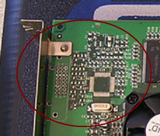

I want to ask something. on PCI version of the V5 5500, the board has holes/locations for DVI output but I saw no cards having it. would it be possible to add the missing things and update the BIOS to one that suports it to have it on the card??????
or has I already said, TV-out(hard) or maybe dual VGA output(hard too)
It's possible. If you have the knowhow and the facilities to make this sort of operation then it's possible. Then you could pick up a dvi bios at Stanto's site:
http://welcome.to/3dfxbios
Knuckles
yeah, I saw those bios, but , I'm not good on adding things on a card, the only thing I'm thinking is, if I do it, maybe the card won't work after I did it....maybe if, someone, I don't have the instructions/pieces/tools for this and I don't want to screw everything to end with a non-working card ...again!
I am assuming that you would have to add more than just the connectors. How much stuff would this be? We're still talking v5 5500 here.
Knuckles
yeah, i know that, but all the connections for resistor/chips/port are here. it should be possible in some way....... Hank???
Download Attachment: untitled.JPG
