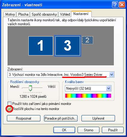

go to display properties/settings.you should see something like this (voodoo3 driver is already installed).your radeon card should be selected (highligted,its the monitor no. 1)

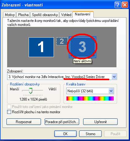

select the voodoo3 display.(you can choose the resolution for the voodoo3 now.mine is 1280*1024*32.just like the radeon.)
40.95 KB
check the "extend my windows desktop on this monitor" checkbox.
39.96 KB

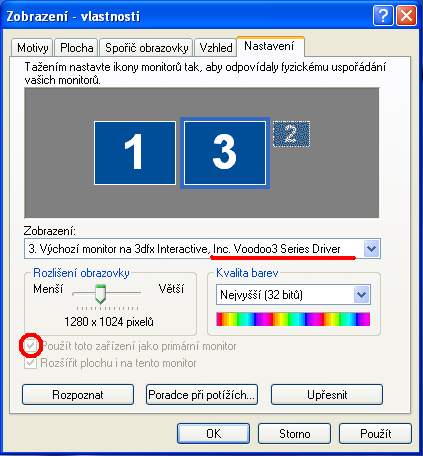

check the "use this device as primary monitor" checkbox.
38.9 KB

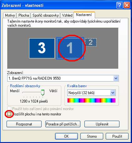

select the radeon card (monitor no. 1).uncheck the "extend my windows desktop on this monitor" checkbox.
38.35 KB

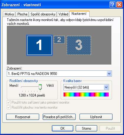

click apply,the screen will go black,turn off the monitor,plug it to the voodoo3 card,turn it off,you should have picture.reboot,and you are ready to roll.with a little practice,you can do it in five seconds..
