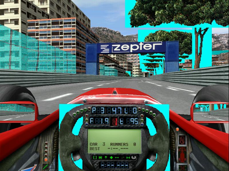

Hello! Sorry for the late of the answar ;) No, my v5 5500 run with 2 chips... But there is an other poblem... You know Gran Prix 3? Look this:
http://www.forumzone.it/attachment.php?attachmentid=457&d=1252704699
I think it is not normal the square around the trees etc... I've tried to run the game in high and low detail and there is the same problem... I think is my videocard... For you? Is the game or the videocard? How i can test my videocard well?
And the game which i can test the videocard? Hitman 2? Please, tell me a list which i can test with the videocard :)
thanks lot! :)
