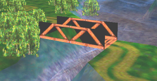

With an old D3D benchmark I got some transparency issues, see picture below:
57.88 KB
The shown object is a bridge over a river.

Rolo1 I presume that you are running with Texture Management enabled. How does your 3dmark 2001 score compare with that from the alpha 32. Have any of these tests showed different results from the alpha 32. basically have any of the test results changed significantly from the alpha 32.
Yes, texture management was enabled.
I will run 3DMark2001 on Alpha 32 and 33 and post the results here on Sunday evening ( I am 2 days off ).
