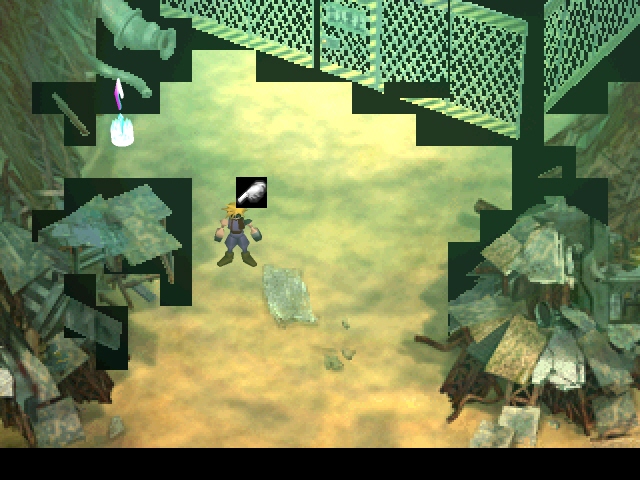

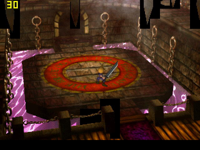

yes.no difference.it seems like some textures have borders that are normally transparent (or not displayed),but something is wrong and they are black.here are some real screenshots:
incorrect
correct
tested on voodoo3.I think vsa-100 based cards have the same problems (see page 44),I can test it on voodoo4 as well if you want..

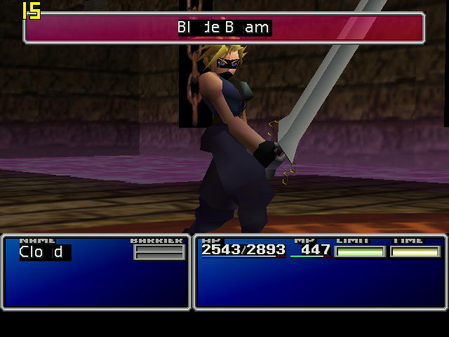

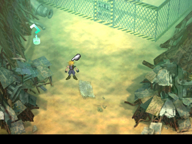

here in my v4500 (some missing textures in Cloud's eyes):
60.94 KB
43.88 KB

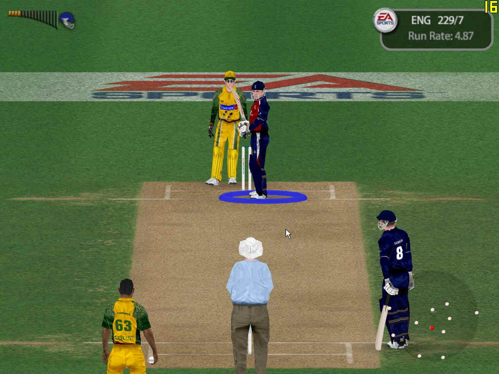

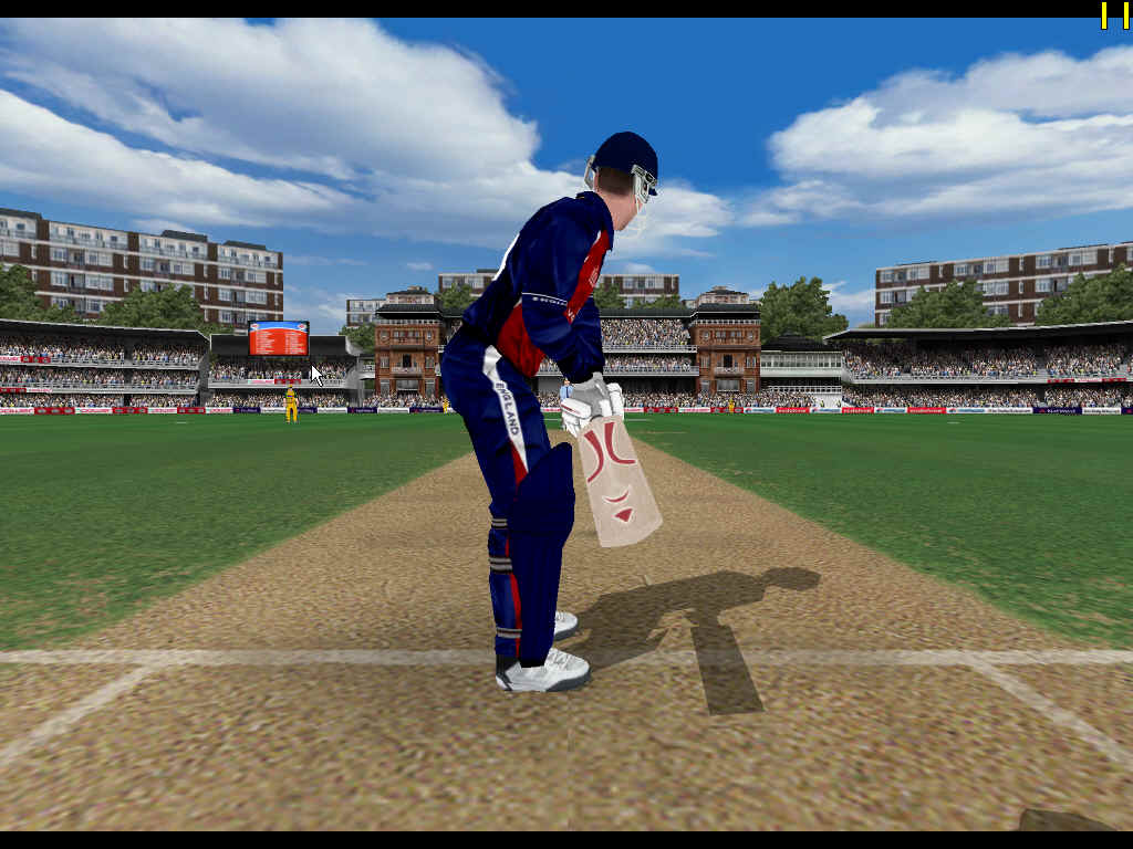

EASPORT CRICKET 2005 demo works relatively well with SFFT Alpha 31.
79.55 KB
85.89 KB

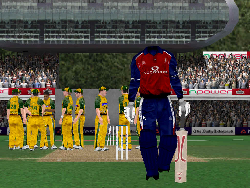

This SShots lacks textures (not head and not foot)
102.24 KB

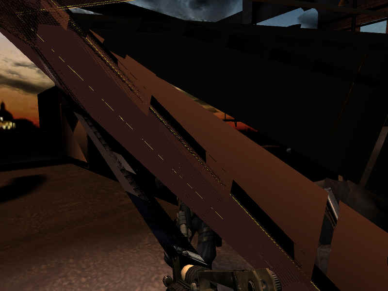

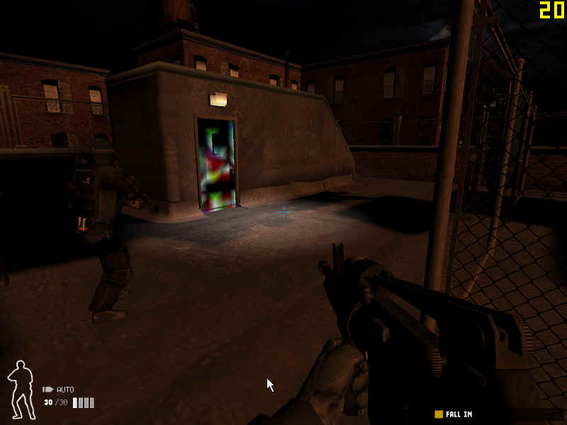

SWAT4 demo continues with bad textures.
30.89 KB
29.24 KB
