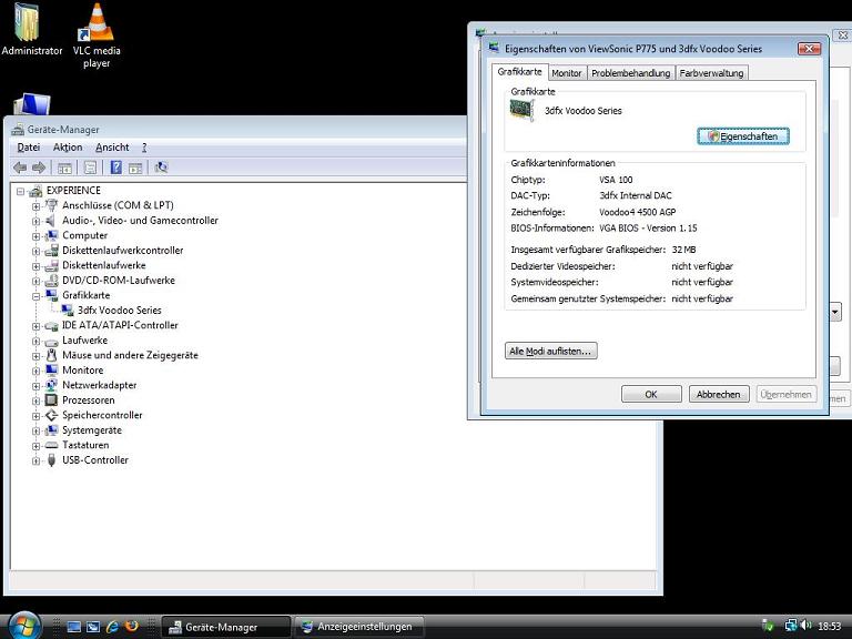

I tried the new SFFT driver 1.5 in Vista Ultimate x86 and :
It works fine in 2D, Direct3D and Glide !
62.45 KB
These're great results.
I want to thank all you, and not only the "new entry" DaMulta (you're welcome) and "our old" Rolo01 for their screenshots caputerd by Windows 7 and Windows Vista systems (:)).
But...please note this's not the final step but it's simply another step. And so, of course, any newer report'll be appreciated and useful for us.
very nice.to be honest,I did not expect the driver to reach full vista compatibility so soon..
incredible work! [8D]

one of the guys from 3dfx.cz has tried out the 1.5 driver with the latest win7 build,and it seems like it works fine on a voodoo4 card (d3d,glide and opengl alike) while failing on a voodoo3 (BSODs,lockups,awful 3d performance)..still amazing ;)

So voodoo 4/ and I think voodoo 5(not totally sure have not test a lot of stuff)works in vista.
I only got a blue screen when I tried to alt-tab out of a game that was just glide. It didn't like that so much lol.
I've been benching Vantage for about 8 hours straight lol....I has a new trick now tho.Freeze the voltage regulators. I added ice into the water line after it failed 10 times in a row. Then past. Then clock it higher and yep. Just need to get another TEC and or Dri ice to throw in the line.
just received a confirmation,v5 works as well,sli,4xfsaa and everything :)
